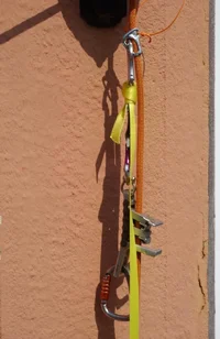

Family Tree you got me thinking and I have been climbing with this for a few days. Tibloc for top ascender, Uni in the middle and pantin and loop at the bottom and it is very light-weight and gets rid of (most importantly for me) the secur.
I like it so far, it is REALLY light-weight for an SRT system and you can, if you want, charge up the rope!

Have you used the Tibloc much?
When it first came out I used it on some KMIII and it really picked the sheath. After a couple of days of climbing it looked like it had gone over barb wire. Since then the Tibloc has been rattling around in the bottom of my 'ascenders' bucket with a couple of unused figure eights.
Do you have the shackle then biner on the top of the Uni to keep things aligned and fair? Why not just clip into the top loop of the Uni?

Tom, the shackle is there just as you say to keep things fair. My ice climber friends rated the tibloc a few years back and I was struck by the design sense, I actually purchased mine two weeks ago in Atlanta with Peter Jenkins at the end of my facilitators course, it is new in body but not in mind!
