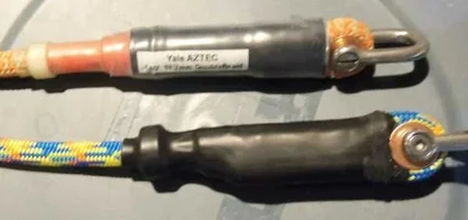

If it's not midline attachable, the ingestion into the adjuster problem is easy to solve with a nylon bushing... I don't like the splices of lanyards/climblines getting slammed into pulleys, multicenders, adjusters, etc. and go out of my way to beef up the protection for the splices on them all (see pic) and use doublewall, adhesive-lined shrink tube to keep the nylon bushing in place.
