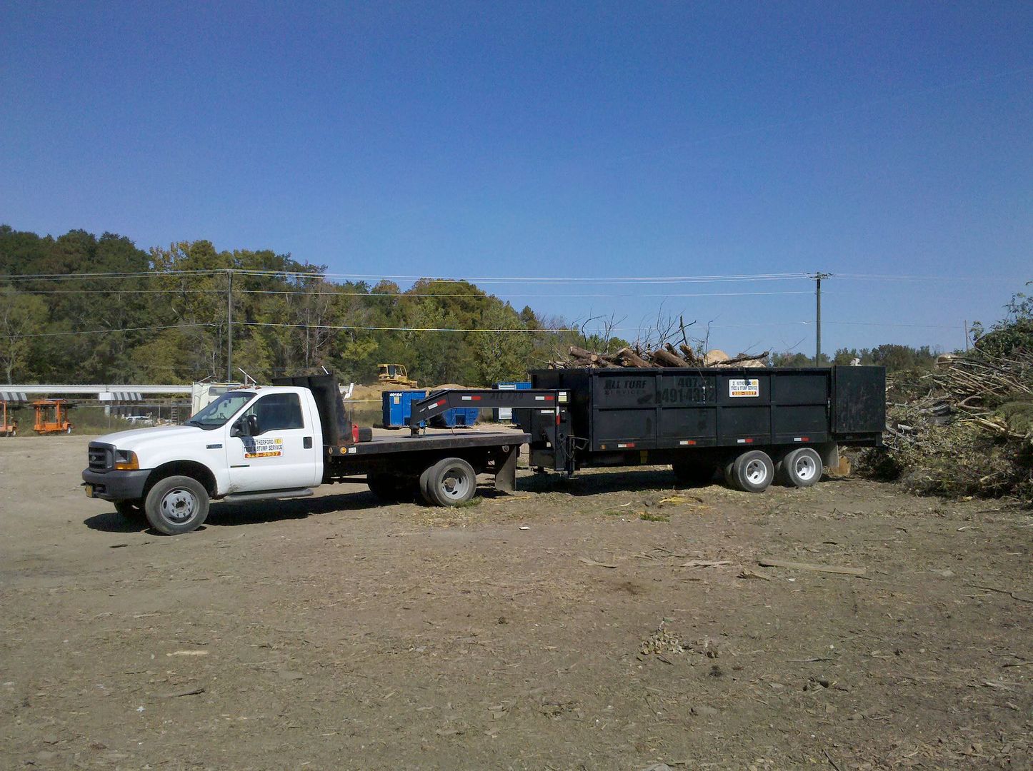

I'd get a 2005+ F550. The 05+ have a different front end that allows for seriously good turning. The F250-F550 all use the same engine, cab, and transmission, so if you're getting a dual rear wheel work truck, you might as well get as heavy duty as you can.
My currenty work truck is a 2006 F550 4wd auto with 6.5klb/13.6klb axle ratings. It turns almost as sharp as my Civic, way sharper than my 2000 F550. The most I've grossed thus far is 35klbs.
2000 F550:
