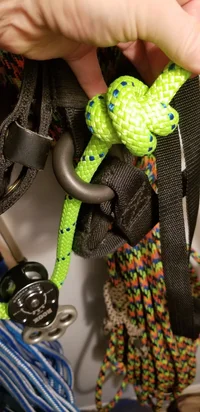

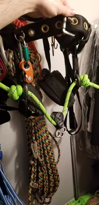

While we're on this subject, I just replaced the bridge on my Buckingham Puma saddle. I used 1/2" New England KM III kernmantle with a 10,000 lb tensile strength. The factory bridge was smaller diameter and had a girth hitch at either end. Does anyone see a problem with my new set-up as pictured?

Looks good to me. Kernmantles have a thin sheath, but with the Rook on there, I doubt if you'll have any trouble. Just keep an eye on it. Let us know how it works out, down the road.
If the stopper knots start looking like they're trying to squeeze through the rings, try something bigger... like an Ashley's Stopper Knot.
KMIII is a 100% no for bridge material. New England ropes says minimum 8:1 sheave diameter for a reason. There is nothing in the world you are going to run on your bridge with a 4" diameter bend radius. Nor should you use teufelberger's Xstatic, Atlantic Braids AYA, or any other rope that states clearly that it should not be used in a moving rope configuration. A bridge is a constantly moving rope with all the wear concentrated in one place.

I hadn't seen their no-go for MRS with KM-III before. But, it does have a thin sheath. Maybe that's the reason. Thanks for the information! I've noticed that some of the harness OEMs are OK with 16-strand ropes... those have very thick sheaths.
Whatever u settle on using, I highly recommend u tie off the cord to the rings with dbl fisherman's knots.
I looked around for the 8:1 sheave diameter recommendation for KMIII but couldn't find anything. Probably didn't try hard enough ;-) It's all about the core not the cover for a static kernmantle so this is about the nylon core and construction right? Curious to know more, is it about the Nylon or is is about the core construction and the Nylon? Very interesting.
