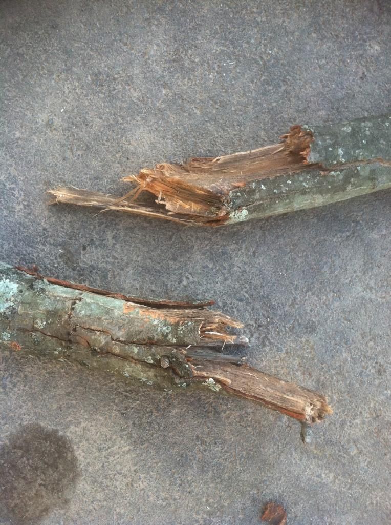

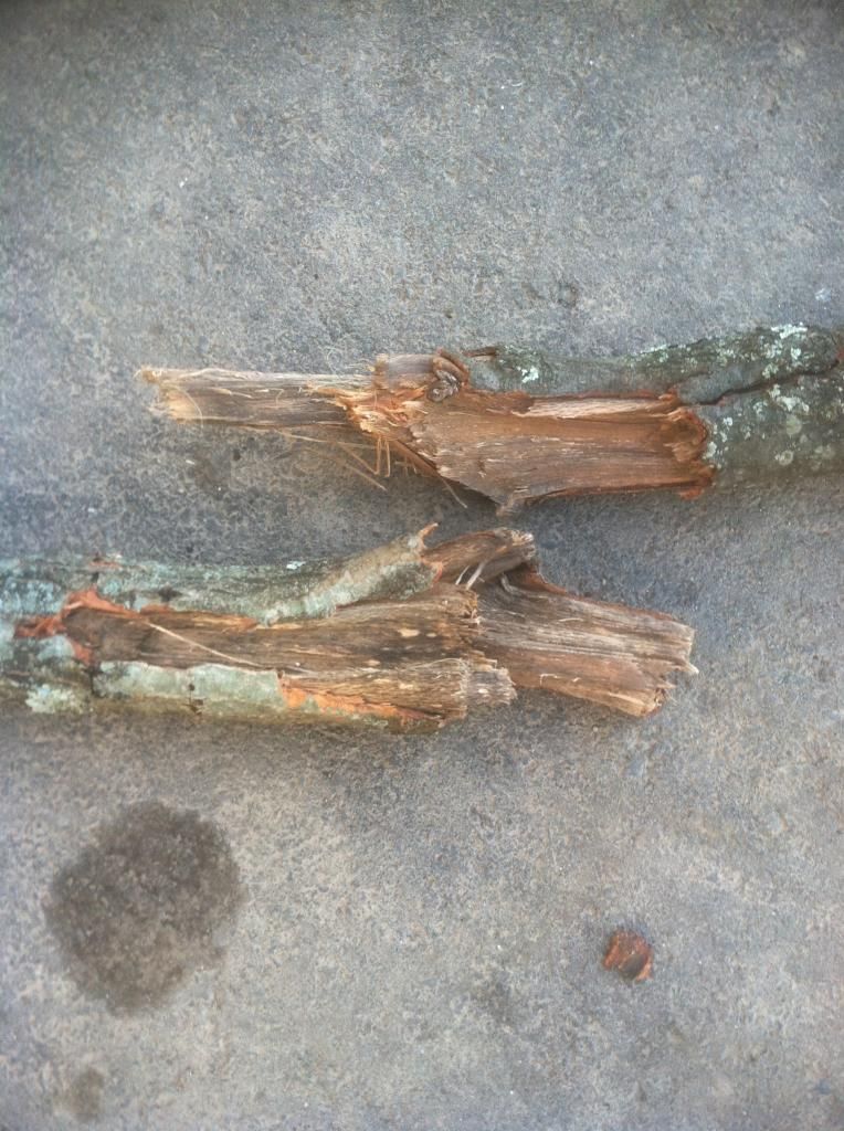

Finally saw the break that lead to my injury.
Does look like that branch had been cracked before. Could you see where the rope was? Did you keep it?
It does appear to have been cracked. I didn't notice it but I believe it was a few feet up from the break.
This is still at the yard. Next time I'm out there I'll bring it back so we can do some analysis.
Yeah, TL, couldn't see that from the ground and I didn't register that when I loaded the limb. I wanted that limb to work so I could get up there. Once it passed the load test, I was good to go. Finding the evidence to support my belief.
The broken piece you show in pic was under your TIP by what would say directly or a few feet under and was that a more vertical or horizontal limb ..I read first post from accident you said 4 in correct? Were you directly in a crotch? . I had a TIP break out on me years ago . I was not in the crotch completely only six inches outside of crotch 4 plus inch diameter red oak .
According to my crew, my rope was about a couple feet above this point. The limb was angled upward, possibly 30 deg. It was definitely a bad set. Going through my thoughts at the time, I was justifying a poor set after several shots at my intended TIP. Once on this limb, I then decided it would suffice to get me to a point I could advance from. Basal anchor set, I then loaded the limb, some flex but it held with my full weight hanging on it. Instead of taking the time to reset I rationalized that it would be ok to get me in the tree. Where I should have stuck to proper protocol I took a shortcut. What would've saved me 10 minutes has cost me and the company at least 6+ mths let alone the pain and frustration of dealing with the healing process.
