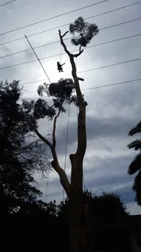

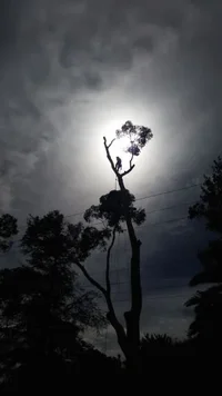

these are two I took before the first ascent day 1.
View attachment 30771 View attachment 30772
Awesome picture/tree. I have to ask, because I see a lot of nice looking, large eucalyptus removed. Do they become hazardous when theyre larger like that, or do people just not like trees that large near their homes?
We dont have any around here, but we do have certain species that people take down once they get too large because of decay issues, disease, etc.
same situation here, some species like this sugar gum have inherent issues.
this particular tree failed a major leader into the high voltage primaries and across the roadway.
on inspection of the failed section and the other major unions it was decided that the time to remove had arrived and some hustle would be required before the next failure occurred.
main reason was the amount of vehicle and pedestrian traffic followed by the children's park just opposite the tree and then the residential houses under the tree itself.
wind loading in that area also played a part in the removal assessment.
hope that covers it.
Ben.
