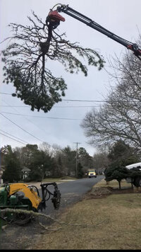

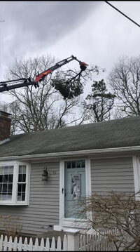

Here you go!

Everything still working up to snuff? Better than expected?
Any unforseens?
The only issues i have are with the western star truck. I’ll be bringing it to the dealer soon for a leaning airbag and an air leak (possibly caused by the bag). The air tank pressure leaks down from 125 to about 50 psi in two days.
The crane itself has been great!
No issues yet. Pretty simple to get the hang of it. My setup time has improved as well.
I’m currently trying to work on multifunctional movements for a more fluid move from tree to ground while trying not to shake the boom…It will take a while to be smooth.
I definitely love this thing.
