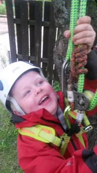

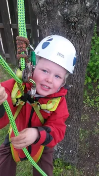

Now my soon-to-be-three-years-old son has made his tree climbing debut.
He seems to like it!

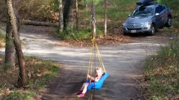

I've been using the bdb swing

Yup, it's an Edelrid Fraggle II, size XS. There's also an XXS size available but it was too small.
Seems to be working just fine, he says it's comfortable to wear and I feel fully confident when he's hanging in it.
I rigged a hitchclimber and a Distel hitch (Tachyon/Armor Prus 8mm).
I noticed two things:
1. Due to his low weight, the hitch can sometimes slip. I will experiment with other cord/hitch to see if this can be remedied.
2. When hanging, he instinctively wants to grab the rope and often end up grabbing the hitch which, of course, causes him to go down. One has to be careful to avoid uncontrolled descents.
Thats great! They have so much fun up in the tree. I want to teach both of mine to start limbwalking this year.
As for him grabbing hitch, try putting an extension between harness and hitchclimber (short sling or a dogbone). Also, try tying stopper knots every ten or so feet under the HC.
yes the bdb is holding up the swing. Not needed though a knot and caribiner would wrk fine.
