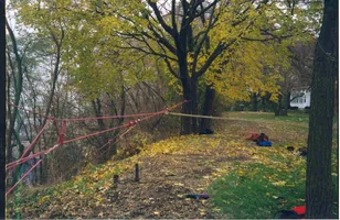

I did a job for a military base last year. We were doing "vista prunning" for the generals mansions. We had to set an anchor between two trees at the top of the slope rap in and bomb the tops to the bottom of the slope and clean up from there. it seem like topping to me . It was super fun to put the ground guys onto SRT with grigris to get up and down the slope. And they loved it. They have been asking " are we going back there this year?

Pointer, it was a the great lakes naval acadamey. We had to do a job briefing with a seal team. They wanted to kanow how we planned on dealing with the steep slope. We basically had to claer cut all the small stugg and "prune" the larger trees. I will try to find some pics.

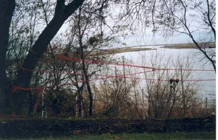

Heres a couple of pics of the slope. We were clearing a 50' wide slath. All the men, climbers and ground men were on rope the whole time. They were connected to the traveling blocks. We got the rope as tight as we could with a 3 to 1 ma. and put another tope going to a tree on top of the slope to keep the bounce to a minimum. It all worked out pretty good.

Tod- looking at that picture of the base of the trees at the top of the hill...all those ropes going every which way....is that the rappel anchor? From the perspective of a rock climber...WOW. Lots of rope.
Is that what the ropes were all for?

Nick, sorry I missed your post about that slope job. It is all one rope going from tree to tree rigged into a 3 to 1 to get it as tight as possiable. The crew then tied into the rope via a traveling block so they could work the 50' wide area. The slope is about 80' down so we went srt. via gri-gri to go down and a hand held grab to go up.
Here's the end result at lunch time.
