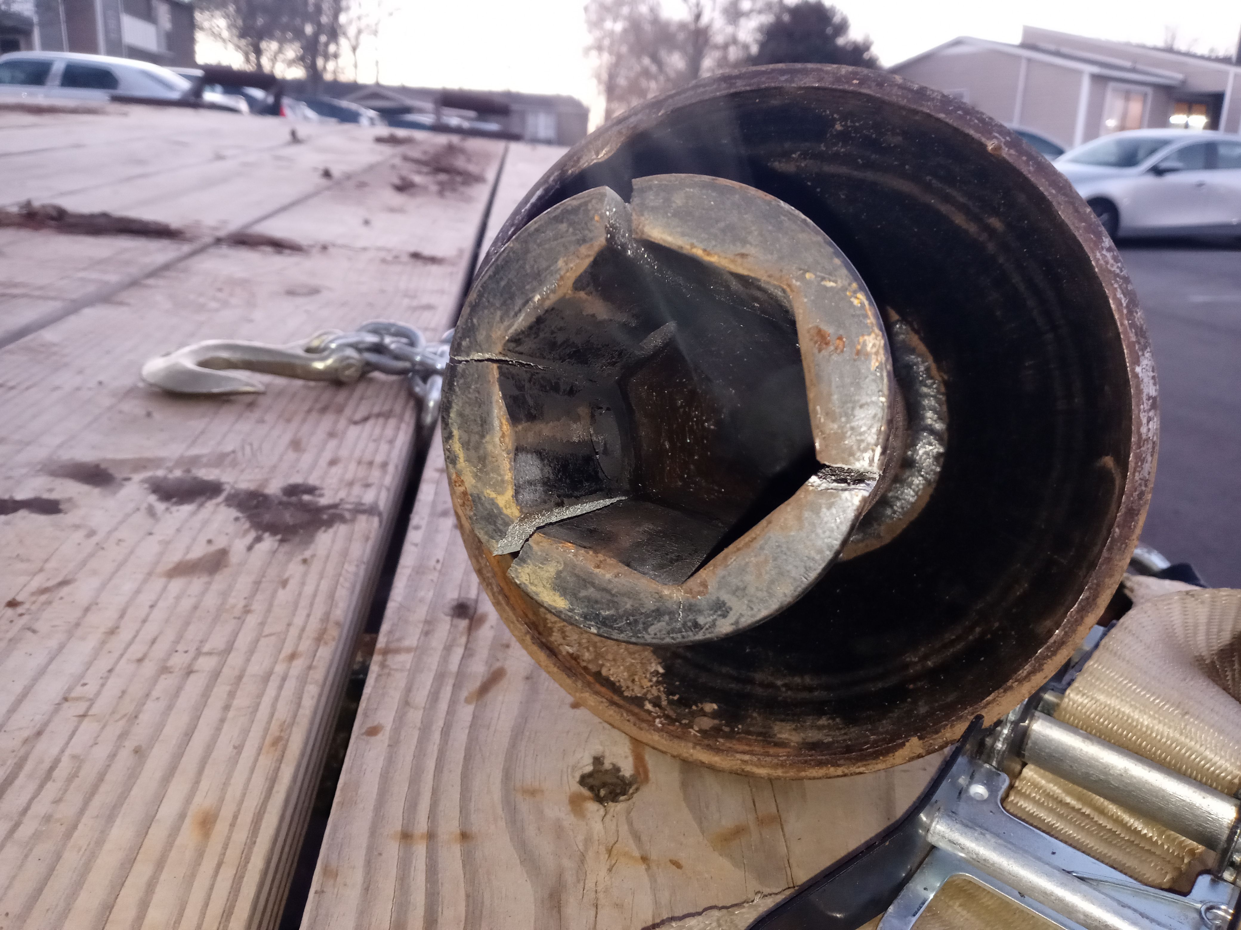

Broke the hex on our atom splitter today!
Ouch! Do you ever pull sideways on that splitter? That looks like a lateral force break, unless you just really put a lot of torque into it and split it out that way.
Maybe wrap a piece of plate around the next one, to give it a bit of extra reinforcement.
Yep. No way to avoid sideways pulling when a log is rolling around. I think a machined sleeve around it and welded on would really help.
We are using a 3300 ft lb rated auger drive. The hex on this has always been kinda sloppy. Wonder if that didnt help things.
I thought that might be the case, and that’s probably what broke it. The machined sleeve probably would help, a strap/band rolled around would probably work just as well and might be stronger? I’m not an engineer though so I can’t say for sure.
If you do have a sleeve machined, friction fit it - make it a little too small, heat it up, with an induction heater or in a real hot oven, and slide over. When it cools, it will lock up real tight, and actually make the coupler stronger yet because of the force being applied by the ring.
