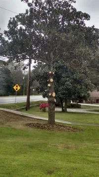

For this unnamed city in the deep south. I don't know who did this or why, but it happened yesterday. I'm putting it out there for comment.

I have a question of all seriousness since I don't know. If that had to be done for would you be better leaving some stub so you were away from the trunk and collar or would you still cut at the collar? Best I could see they just wacked them off flush to the trunk, I'm not talking that kind of cut, just the normal pruning cut, or say maybe move it a foot outside the collar.
Always at the collar. the trouble is with large limbs like this, many times it is difficult to determine just where the collar is. Mags are easy as they usually show huge collars, but many trees don't. I am very leery about removing anything bigger than 3-4 inches in diameter. I have to have a VERY good reason to go bigger. I don't get paid by the pound like so many around here do.

I like to leave stub hopefully it sprouts and creates a smaller wound away from the stem than at the stem. 6 of 1, 1/2 dozen of the other .
At the collar.

I believe the issue on Oak's maggie is large flush cuts and far too many of them made at once.

In the very rare occasion I have to take such a large limb, we have left a long stub of 3+ feet. The thought is at least it will sprout, and take more time for decay to get into the trunk. I can only think of once or twice in the past 11 years where this applied.

I talk a lot of clients out of lower large limb removals, but it's not that rare for me. Not even close. I wonder if it's the kinds of trees you're dealing with in WA. Around here we've got a lot of decurrent trees, and a lot of tallish trees that become decurrent as they mature (sweetgum, tulip poplar). I understand the argument for leaving long stubs. If it is a lot healthier for the tree, I suppose I could learn to see it as not so ugly. When there's a collar, I cut there.
I try to cut just outside of the collar. If it's not real clear where the collar is I'll cut out an extra two or three inches.
That does seem excessive. Possibly done for homeowner visibility while backing out of driveway? Still too much. We elevate often, usually minor cuts to allow head clearance while mowing.
