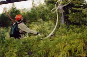

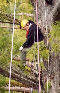

Re: Nick\'s Pictures....
Here's Dan, taking a rest while his partner, James, works the tip of a branch.
ps- in Marks defense, he was not actually pissing in the tree. He was adjusting his friction hitch.

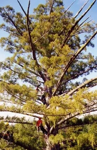

from here you can see all the dead in the top of the tree that we weren't able to get. the rain delayed that, but if i understand correctly, Jerry and a crew went back last weekend and finished the tree up. how'd it go, guys?
Nick,
The Tree House went well. It took us all day Sat. to finish up the top end of the tree. We set up a diffrent type of speed line then before . One that would allow us to move the limb just outside the canopy and then let it down to the ground . All controlled by us in the tree.
Glad you didn't get me peeing in the tree. At least that guy used a bottle.I had to find a secluded spot ...lol..
I'll let someone else elaborate on the day if they want to .
Greg .
