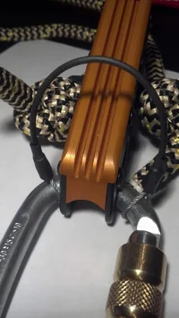

Here is mine, 5mm Maxim cord and electrical tape. NO Stitching.
I want to thank you guys for such a simple/quick idea that seems to really work. So far I just use some cord and tape and haven't even stiched it yet (although I keep meaning to)
Beats the heck out of screwing with wire.

I am glad the short tether works for you. I have been meaning to try (low and slow) using an eye and eye cord as the tether to the oxan and clipping the standing line of a DRT setup onto it and seeing if it works.
Testing has shown that using an attachment hole built into the frame of the HH does not work.

I can understand why an attachment to the body does not work because as it is pulled up the oxan is going to provide pressure and fiction against the rope in the same manner as when you are descending. (opposite but same function)
But this is my observation; do you have to been concerned about any of these attachments getting into the sliding slot of the HH? I guess the worst that could happen is that the HH would not provide normal friction and the hitch would bind stopping your descent? Seems like a U bolt with some kind of eyes to attach to the oxan would be great and impossible to bind in the slot of the HH.

I initially used some throwline but it worked its way in the slots. It never caused a problem but it was notable. I definitely didnt want it to muck up the action so thats why the 5mm cord was used. If you look the 5mm is thick enough it wont go through.

A U bolt would work by virtue of it's rigidity. Of course, threading it onto the Oxan would be impossible so the solution must be something as rigid as possible with enough flexibility to install it.

I was thinking of a Ubolt with a larger, fender washer welded to the ends. (kind of like an eye splice) The length such that it cannot bind at the top, the rigidity so that it cannot enter the slot and maybe such that the washer would cover the slot and even prevent any debris from entering but yet still provide full mobility to the Oxan.
I know I'm talking about a little welding but would that be attachable?

A U-bolt of the correct proportions could easily be produced out of flat material and bent into shape. The problem with all of these tethers is the sharp and constantly changing angles of the carabiner/HH interface. Add to that the lack of room and the need for the carabiner to have full mobility and the solution is a challenging problem.
Maybe something like this?

In your pic the "u" bolt removes the rope friction against the Oxan, correct! Would it then be possible to use an aluminum connecting link without fear of excessive abrasion?

I believe the wear concern with aluminum biners is the connection between the tool-steel body of the HH and the top of the biner.
With an aluminum biner you could expect some serious gouging which would lead to a very un-rope-friendly connection and decreased strength and life of the biner.

There you go! Looks like a perfect solution, well done Dave. Time for me to put in my order to buy one now!!!!!
