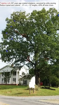

Tear-out wound leads to questions
Genus? species?
Trunk diameter?
Extend of cavity? (dimensions)
Thickness of sound wood in the trunk? (the more accurate the better) tomography, resistograph?, by feel with a drill w/thin bit, sounding mallet or visual estimate.
after a very thorough analysis of the entire tree and site.....
Presenting the client with ALL of the management options in a concise written report so they can decide what is the best decision for them.
From the one image I could see a very extensive canopy reduction being performed that would certainly cost more than $1000.00 imo. The client can get multiple quotes to perform the work that is specified in the report under Management Options : Retain the Tree.
Removing the tree and planting a new tree may be the best case scenario, I don't know.
Under the Management Option: Retain the Tree section I would also recommend applying a growth regulator, specify inspection cycles and continued monitoring by the property owners. Managing growth to minimize forces exerted into the compromised trunk is the longterm objective. Risk of failure still exists but is lessened over doing nothing.
Keeping this tree in the landscape for as long as possible is a continued, on going relationship that the "owner" of the tree has to be willing to commit to. It may not be the cheapest longterm option, but that's not really my concern when I'm asked, "What can be done to save this tree?"
Based on the picture, what can be said about the tree, and what services might be reasonable to propose?
Owner has heard multiple removal recommendations from removal companies, and wants an objective opinion.
Any better pics? that one doesn't show detail
Thanks Stacy. Not sure that a kingoakedits 1505.webp 'very extensive reduction' is needed, as the tree has stood up to everything thrown at it so far.
Kevin the pic shows a lot of detail. Sorry I had to resize to fit size limits here. i'll put the album in a blog post, and put up the link.

Quercus sp.--velutina? not sure; I wouldn't waste a lot of time on taxonomy beyond that.
"Trunk diameter? dunno Extend of cavity? Thickness of sound wood in the trunk? (the more accurate the better) tomography, resistograph?, by feel with a drill w/thin bit, sounding mallet or visual estimate."
This datum is hard for me to use; if it's thin or thick, so what? i've seen oaks with 9' girth standing on 3-6" shell wall, so how much accuracy is needed? t/r formulas have no basis whatsoever for trees >36".
"after a very thorough analysis of the entire tree and site.....Presenting the client with ALL of the management options in a concise written report so they can decide what is the best decision for them."

"From the one image I could see a very extensive canopy reduction being performed..."
The tree has stood up to decades of storms since it got topped. So, why is an extensive reduction needed? Even if the cavity is deep, and the response on the left side is weak as it appears, what conditions would make you spec >3" cuts or >20% off?

Thanks Stacy. Not sure that a View attachment 32062 'very extensive reduction' is needed, as the tree has stood up to everything thrown at it so far.

I'm not sure a very extensive reduction is needed either. But at some point in this trees life, it may become necessary if the trees owners want to do everything in their power to keep the tree in the landscape.

But Stacy I gotta wonder where your suspicion that extensive reduction will be necessary comes from. ?
Doesn't sound likely to me. It's typically gradual, and often one or two reductions last a long time. But yeah when I see it the specs might get tweaked a bit...
My suspicion arose from one medium resolution image with little details about the tree. To be clear, I am not recommending that an extensive reduction needs to be done. I was imagining a worst case, extreme scenario and a client willing to do anything to not cut down the tree. I agree that a little, well placed reduction goes a long way.

Extremism in the defense of better tree care is no vice! (from an election 50 years ago). some random ?s
If the request is in writing, do they provide details about the assessment that led to this proposal?
Does "hazardous" mean 'in a condition that requires action to meet owner's comfort level'?
Which part is likely to fail and where will it break? What can be done about it?
The OH champ red oak is 9' near the base and 3-6" shell wall. Assessed by me and also 6 smart people. And there it stands.

Heard nothing from the owner for a week so I thought she might have had it whacked, but no; we got the goahead to prune it late July.
I put 7 hours on it figuring 1 hour driving time and no cleanup. So we'll see how it looks then.
I'm guessing that the 3-man crew and maybe even a goat can fit in the hollow! :buitre:
