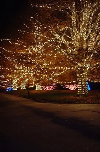

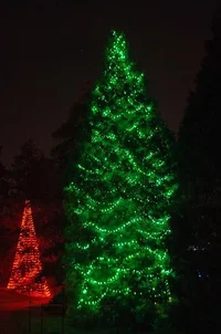

YoungBuzzer is right at Longwood the arborist crew installed around 217,000 lights last year on just under 4500 strands. This year we are on pace to install slightly more due to finished construction. We began the day after Labor Day and will work all the way until Thanksgiving. We stick mostly to the 2 forms Buzzer spoke about and do just a couple of what I think you all are doing. Ill attach a few picture for your enjoyment.
This is 3 of 6 holly trees we used to decorate.

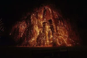

And this is just a really cool one. You would never think that Christmas lights would make a tree look like this.

It is really tough at first. This is my second year doing them and I think I'm finally getting a hang for it. Its great practice/training for climbing out really far. Alot of us are using redirects (natural and retrievable pulleys) to get out really far, especially on those Copper Beeches in the picture above. Takes time getting used to that and also carrying gear (a ditty bag filled with caps, multi plugs (cube taps), a bundle of lights and various sizes of extension cords).

These posts are great. Keep them coming. The copper beech pics are intense. I like your style! Do you actually secure each bulb in place or do you drape the string and attach...here and there? What makes an installation string of lights from Ok to GREAT? Is there such a thing as too many lights in the tree?

Making a tree go from ok to great has very little to do with the lights (LED is better though), it comes down to the time and care you take in stringing the lights. If you look at the pictures which do you like more the green conifer or the copper beeches? Which would you rather see on your street. If you take time to make sure that the wraps are tight (so they dont slip), and the spacing is consistant you will be much happier with the outcome. As I mentioned before we do very little "draping". We either wrap the branches, do the cone form or we hang lit orniments. Maybe the Buzzer and I can come up with a video to show exaclty how its done. We have 8 white oaks to complete and it would be a perfect time to do such a demonstration.
