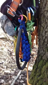

I have one end girth hitched to the biner, then twist the sling 3 or 4 times and clip the other end in the biner.
Nowadays I use a 3/8”, 3’ ultra sling. I clip it similarly- first eye is girthed, clip last eye in, twist 3 times, clip middle eye.
Next I want to try a snaketail by art.
