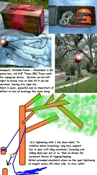

Sometimes i brace with tight line med.high against the lean to stabilize tree to climb and rig. Present favorite is using a chain hoist tightening a line through a friction hitch. If anchored low, run around the tree high, then chain hoist used to tighten leg returning to ground ('U'-s around target tree) gives 2/1 - friction bracing 30'-50 from ground (real leverage). Adjust chain hoist tight; lock line off, and then fully extend chainhoist again. Plenty of tightening available on the spot to rebrace, after weight comes off the lean side bracing fights.
Sometimes loosen to slide down spar, to tighten again; and take piece were bracing was. Vertical trees, without definitive lean are trickier; must give them 'lean' with one line; then fight back with another etc. i try to imagine welding this super tight brace(s) from ground to target point; farther up; more leveraged support.
ChainHoist is very stashable, though a lil heavier than comealong; with chainhoist you can continue effort smoothly in same direction; without stop/start of come along slowing you down. Also you don't lose power like a come along; for the drum doesn't fill like a come along.
Still no crane- i look at and compare crane with overhead tree rig; as a tree rig is a fixed boom; this idea the bracing possibly.
