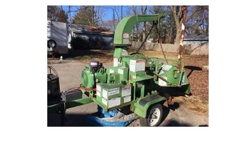

As most of you guys knew that I recently picked up that chipper for a good price of 5500. Want to start this thread to give update on my restoration progress and of course, asking you all experts for opinions and help also to document what I did to it for my future reference and might be helpful for someone as well. Thx
Dived into it yesterday for the first time. Replaced the mechanical fuel pump, rebuilt the carb and the engine fired right up. Ran it for 30 min to bring all the fluid to operating temp and changed out engine oil and hydraulic fluid.
Not sure if the feeding wheel is working right at this point. It only turns when I flip the autofeed switch on, which is not what I expect. It turns when the engine is running idle or full speed. As soon as that switch is on off position, it stops. I’d expect the opposite. With my old 6” Vermeer I used to have, feeding wheel is always on when the autofeed on off, and when the autofeed is on, the feeding wheel only turns when rpm reaches certain number. Looks like I need to dig into the wiring and figure out what’s going on. Does anyone know a source for the wiring diagram?
