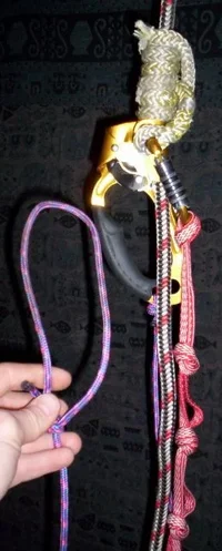

I was curious if anyone was using the two petzl ascenders in conjunction with the pantin and a foot loop on say the left foot attached to the left hand ascender. I think this is similar to the rope walker system but was looking through the catalogs today and considered that kind of set up. I have the blue ascender but have been thinking about the yello(left). Would this be something that would be very effective?
Re: SRT\'s
Yes, I used it a lot but kind of gave it up to practice foot locking. I use the same set up as you described but added a kroll to my voltiege harness to keep me close to the line on ascent.
Re: SRT\'s
With the Frog Walker system I can sit back and take a break with my weight on the chest harness. It feels better being supported at my chest/tummy rather than from the tether going up to the ascender. The reasoon might be because I can go a little limp and not have to support myself so much.
When I used two seperate handled ascenders it seemed to be clunky like Mahk says.
No matter what system is used sizing all of the tethers is critical to maximize effeciency. Get it close and then make quarter inch adjustments.
