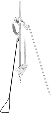

When climbing the yo yo srt system can you use a vt hitch in place of the scroll?
And if you can use the vt should I use a micro pulley with it?
A chest ascender isn't used in a RADS/yo you system. The lower ascender is a device like an Eddy or Gri Gri. Look at the attachment.
What system are you using?
You can use a friction hitch in place of any device. That's what cavers did in the 50's and 60's when they were getting all of this rope climbing lined up.
To keep things efficient you'll need some sort of slack tender in your chest ascender.
I wouldn't advise using a VT though. It is so long that you wouldn't be able to capture all of your upward movement as you walk up the rope. Try using a more compact hitch like a Distel with short tails.
