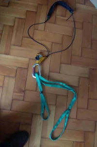

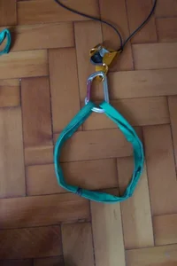

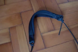

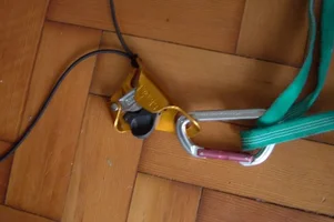

These pics are my el'cheepo setup, using a horse noseband as a neck saver :)

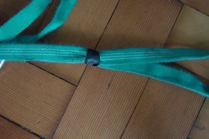

The slings have bike inner tube cut bands to tighten down if needed, I also attach the bungee to my system if needed.
Its better than foot locking, because you can get your knees to your chest and go for full thrust without the worry of missing a rope foot flick...

Thanks for the pics!!! So you use a Croll and a Pantin only, no hand ascender? I thought you were supposed to use all three....

Hey tuttle, that looks like my kind of setup you've got there. I'm having trouble envisioning how it works; can you explain that a bit more or shoot a little video? Thanks!
I'm looking at ordering new climbing ropes, it should be "ok" to start messing with SRT on Poison Ivy?
The bungee works in place of the hand ascender, but if you wanted you can use the croll as a hand ascender and have a long footloop, a croll is a winner because if have not got a pantin, you can just strap it to your boot.
The bungee stretches when you progress and the croll get pulled up, then the pantin on your boot is ready for the next step.
What I do also is just put both my feet in the webbing loop and thrust both legs, progress is captured by my hitchclimber prusik or lockjack, and the bungee is ready to go again, its a no brainer, gives me 2ft > 2.5ft of travel.
