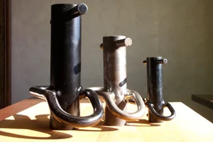

Like Treewhisperer mentioned, use a Port-a-Wrap or a Petzl Grigri. The mini Port-a-Wrap was designed for that purpose. Anchor it to the tree with a cow hitch and better half. If you become incapacitated while working off one of these, a ground worker can lower you to the ground, assuming you are not lanyarded in. If you choose to terminate with a knot, that option is not available.
