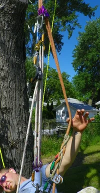

I have a designated 'pick off' strap for a spar or footlocking rescue.
The attachment shows it with a double microcender. I have a single too. It's a 4 to 1 MA system. It could be rigged as a 5 to 1, but then the rescuer would be pulling up. I find it easier to pull down while sitting in a harness. When rigged in a 4 to 1, the rescuer can use a Pantin if needed. I was able to pull my 220 lb. son up by using my arms.
If rescuing off a spar, I would install a 2nd climbing system using an adjustable FS. I have 6' and 20' adjustable friction savers.

pulley saver and hitch climber: 1)pulley saver below the block 2) hitch climber to climber 3) tail from hitch climber to a revolver on the becket of the pinto 4)lift enough to free the climbing system 5) lower yourself down enough to pull out spikes 6) release flip line 7) lower vic to ground.
Does the pinto on the pulley saver allow you to connect the revolver directly to the becket?
I have the pinto rig and the gate on the auto lock revolver doesn't pass between the becket and the pulley. You need to incorporate a loop of webbing on the becket to install the revolver.
I thought I've seen a revolver directly on the becket before.
