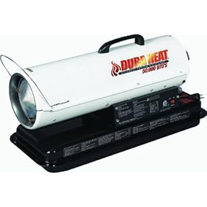

I'll describe a heater setup that I used with great success. YOu do need 110v power or a generator.
Start off with a kerosene forced air heater
The one I have had a 7" output. I bought a 7" to 6" reducer
Buy one 6" elbow and a section of 6" round duct. Don't zip the duct together yet, it's not fun to shoe horn it back open.
Get a piece of rectangular duct. I think mine was 4/5"x 8/10". Like this. You can get fancy and buy the sheetmetal plugs for both ends. I used some plywood to give the box some strength. Get one long enough...you have to do some measuring.
Get a flange adapter
Now...assembly.
Cut holes in the top of rectangular duct the same size as the round duct about 1-2" from the ends. On one end put the adapter, this is input, the other is open for output.
Cut the round duct to the length needed to snorkle from the heater->reducer->elbow->duct->adapter->rectangular duct
Slip the open end under the motor and turn on the heater.
Within ten minutes or so the engine will be warmed up.
I've used this in -10f weather and the engines get nice and warm real quick.
A work of caution for oily dirty engines. Be prudent about using this setup. The heater is an open flame. You could start a fire if you don't pay attention. With some reasonable caution it'll work fine. this setup has been used for decades to warm airplane and remote engines.
