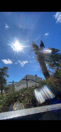

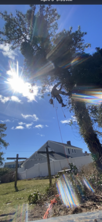

Finally got to test the new setup. It was great. Way easier ascending compared to the lockjack. The tree was a horrible pine with vines to test but no complaints. I’m looking forward to testing again with a better climb. I can see what some people are saying about the hyper climb it has a feel to it like the inner core is separate from the outer sheath , where the older say true blue feels like one solid line. I don’t mind that at all the line was perfectly good for me. Thanks again for all the suggestions. Happy climbing !
