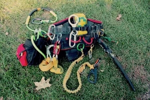

Okay, I think it comes down to where you hang your saw...at least for me. I am right handed and like my saw on the right. Not wanting my lanyard tangled in my saw I hang that on my left. I also feel my right hand is better at opening gates while either hand can work the adjuster. I don't like tangles and sudden yanks, so I put my lanyard in a bag and I tie my loop runners up and keep them hidden under my lanyard bag. I hang what's left spread out along the back, with the stuff I don't use as much closer to the center. I like climbing with a 20'+ lanyard, because I treat it like a second line a lot of the time. Also then there is enough room for 2 in 1 function. Furthermore, I always keep the back end of my lanyard clipped to a Dee. I think that goes back to when I used a simple rope grab that had a tiny wire to keep the grab from pulling through, and I alway backed it up by making sure I would still be caught by the two ends of my lanyard if the grab failed.

I keep the chainsaw on the right/ toward the back. I am a lefty, but that's not the approved hand to use so... Lanyard is on the right as well toward the front. Hang the saw from the top handle with a scabbard on, tangles not really an issue. Keep the handsaw on my leg. Everything else is just down to where it fits.

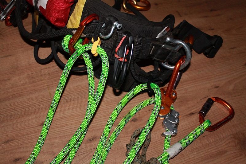

Alrighty, here we go. This is a very bare-bones setup I climb on most often, which is geared towards trimming. Very handsaw-specific.
On the right, I stow my flipline, which is 12' of Luna on a Zillon adjuster. It is my humble opinion that the RE Pirate is the fastest/smoothest operating carabiner out there, and the RE gates in general follow suit, so all of my lockers are Rock Exotica; Pirates on the flipline, O's on the climbing system, and a D for Redirects. My flipline is stowed with a few lanyard manager clips (don't knock it til you try it...they're fantastic) and the end clips into a small Caritool on my right hip, which is also where my chainsaw hangs. Quick tip: I clip my flipline termination OVER the saw, so there's never a possibility that I will get lazy and cut without my second tie-in...flipline has to come off first.

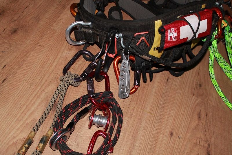

Left side is where I stow tools; my snake tail redirect system, with a double pulley and a rated wiregate biner, all red so they are easily identified (from the ground if necessary), then there are two spare biners and an eye2eye, a leatherman biner knife, and a Silky saw clip sewed into a carabiner tunnel. This keeps it up a little higher so the handle of my Sugoi doesn't work its way through the large caritool on the left hip, and keeps it from swinging/tangling as much. The Sugoi doesn't always come along, though...that's for larger pruning (see Avatar).

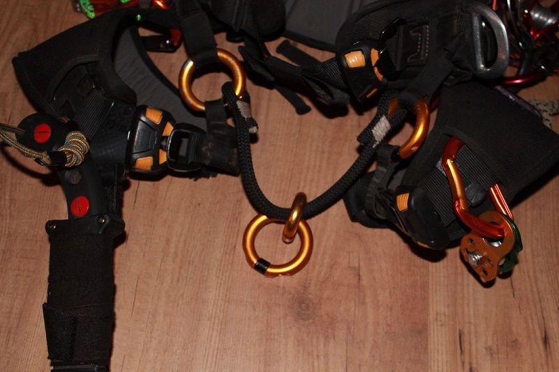

Lastly, my bridge ring has a second (Petzl open) ring running at odds to the first. My flipline doesn't have a becket like you pinto-users, so running the flipline off my bridge requires two carabiners, and, like many of you, I don't like the bridge being pulled at two points at once, so the lifeline stays on the small ring on the bridge, while I can double-crotch with my flipline on the horizontal secondary ring. Planning to replace the smaller ring with a swivel so I can spin under all that, but the second ring will definitely stay...I love it.
Left side is where I stow tools; my snake tail redirect system, with a double pulley and a rated wiregate biner, all red so they are easily identified (from the ground if necessary), then there are two spare biners and an eye2eye, a leatherman biner knife, and a Sikly saw clip sewed into a carabiner tunnel. This keeps it up a little higher so the handle of my Sugoi doesn't work its way through the large caritool on the left him, and keeps it from swinging/tangling as much. The Sugoi doesn't always come along, though...that's for larger pruning.

I talked to Jared Abrojena about his adjustable bridge at an SRT workshop, and he noted that it can creep a touch at certain angles, so he's got the spare rope daisy chained behind it to add a little resistance. I don't want a bridge that long anyway, but I think I'll still hold out for the rollnlock. Something to note...the stock bridge was a little long for my tastes...Jared hooked me up with the shorter replacement bridge, so the stock bridge is the one running across the back for the chainsaw...the length there is perfect to connect those two loops which (I *think*) are for attaching shoulder straps, if you had the SRT version's front connection.
