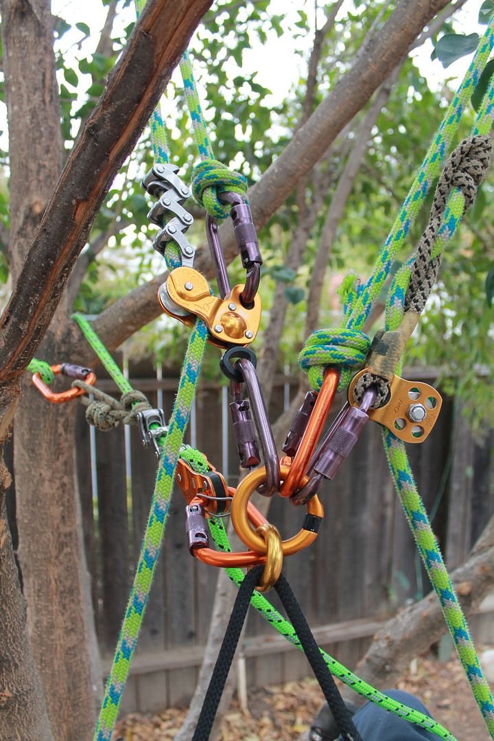

I've added new toys recently (still to figure if they'll stay there for long-term) - will keep upgrading in future. Y'all know it - it's constantly upgrading/making things better - it'll never end.

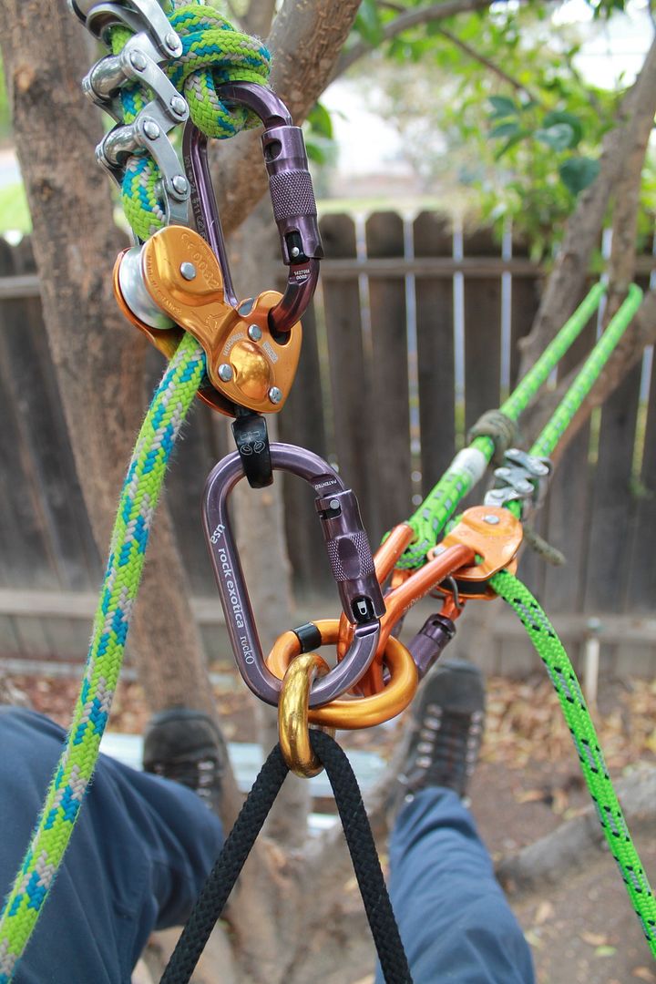

The second ring in opposition is really useful, especially if you aren't running a lanyard with a Pinto and you have to have two connectors for the flipline, but don't want to flood your bridge.
Then, you can switch things up and put your lifelines on the secondary when you double-crotch, putting the working lines left and right instead of front-and-back, no second bridge required. Then, you can put any form of flipline in single-attachment mode (ie. SRT, or clipped to a becket) on the primary ring, and keep all three anchor points centered on the bridge.
Now, technically this could all be done with one big bridge ring, but you don't get things oriented in as effective a manner that way, and if you have a loaded flipline clipped to both sides of your lifeline, it can be difficult to remove sandwiched carabiners, so keeping things separated helps a good deal. I've got plans to replace the small ring with a swivel and add the large onto the end of that, so with 2-3+ connections, I can be suspended and literally spin for work, no twisted bridge, nothing.
I use a swivel in the same way, it's like having two opposing rings... and it swivels...
I also run two bridges, with their own swivels.
Sent from my SM-G920R4 using Tapatalk
Yeah, the larger DMM swivel allows much the same flexibility...you'll notice a difference if you're running a double-adjustable lanyard and trying to organize all of that inside the swivel. Both work, both are different.
