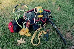

Right side: wire Revolver biner, large DMM ring, HMS biner, oval biner with CT Rollnlock, and oval biner with a small X-ring loop.
Left side: non-locking asymmetrical D biner to carry my lanyard tail. CE lanyard stuffed in the ditty sack clipped to the belay loop in back.
The view from above, using a DMM belay master to clip into my Rope Runner.

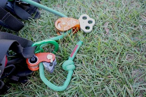

Okay, so I have the same old stuff pretty much. I have recently incorporated the BOLA (lanyard adjuster) and I have 25' of KM III in that bag - I have the other end set up with the hitch so I can do some 2 in 1. A couple of slings and a Pinto, a F8, I have more than just the blood stopper in that pouch, a chainsaw lanyard, a delta link, silky, leatherman skeletool, Rollnlock, Hydra pulley. Oh and I have a dmm revolver on a prusik loop in the red first aid pocket for haul backs and the like.

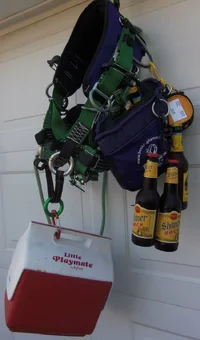

I pretty much run the same system as Macswan does. Have a main cargo bag for all the toys, transfer to a day to day bag for each job and tailor the runout for each climb at the tree with a supply of "I will want it" on hand ready to send up when and as needed. just wanted to show my personnel fav's all on the harness.
View attachment 33921 View attachment 33922 View attachment 33923 View attachment 33925
Bola is working pretty slick for me as well : )
