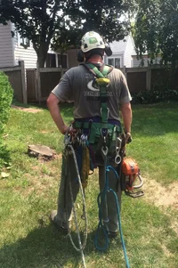

Here's mine:
Buckingham Deluxe Traverse, set up for mostly removals:
Left to right:
Steel core flipline, Petzl Micrograb
Kong Paddle carabiner, for hanging block, rigging line, etc.
Ring and ring F.S.
2 different F.S. retrieval balls, depending on which 1 I'm using
Micro pulley, 'biner and lanyard for making an adjustable length bridge, if body thrusting.
4 sets, sewn nylon loops and 'biners, for foot holds, small rigging, tool hanging, speedlining, redirects, etc.
Short auxiliary lanyard. Making a 15' CE type, but haven't finished yet.
(Lost my whistle, haven't replaced it yet)
Figure 8
Handsaw
Chainsaw on bungee tear-away lanyard, hanging on Kong Paddle carabiner
Gerber knife.
While I'll occasionally use the saddle in the bucket, I added the dorsal harness primarily as suspenders, just to keep things from heading "south".
Mine with all my goodies.

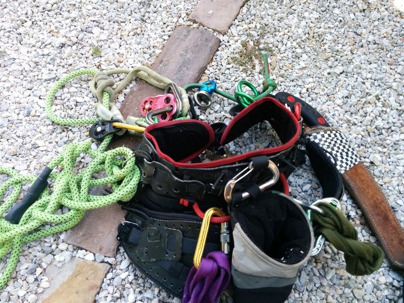

I'm a minimalist climber so this is all that goes on my saddle for 99% of climbs. Plus handsaw on my leg, foot ascender, chest harness, and choice of chainsaw to finish the ensemble. HAAS gets thrown to ground.

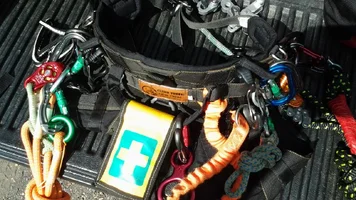

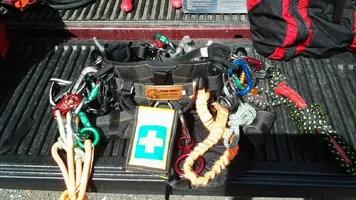

My "2015" harness looks like this now. It is a Singing Rock Timber 2 harness
Under my left hand:
Here I store some carabiners for whatever I need them in a canopy, next to the back is an accessory ring on wich I usually clip my gloves if I need to take them off to tie a small knot or just use an iphone to take a picture, next is a small Caritool where I place rigging loops, redirect loop and other usefull stuff depending on situation, sometimes a handsaw, next (on the back) are my two small biners for a small bag with usefull goods, small water bottle or whatever (not installed).
In the upper middle part of my belt I place the First Aid kit.
Moving to the right:
Small folding razor sharp knife. next harness loop is commonly used to place my second lanyard(the longer one) and a chainsaw lanyard end, the right hand Caritool is used to held a chainsaw lanyard handle ring.
