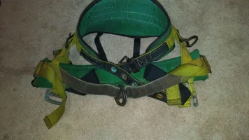

Show us your harness
Haven't changed it in a couple years. I really like it for big saws as it keeps the weight evenly distributed. If you have suspenders, it's even better.

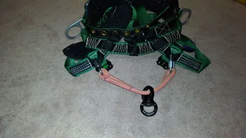

I can't document why, as I'm no expert on the subject, but I was once here on this board led to believe that hitch cord is NOT a suitable bridge cordage substitute...careful.
It's not so much that it's a hitch cord, but more what it's made of. Technora and Vectran cored cords are a problem because they are self abrasive and with a cover over them you can't see the wear. The Ocean Polyester has Vectran only in half of the cover, which isn't a problem.
I read something similar but I think it will be OK in this application. This particular cord was developed for sailboat racing because it has a high breaking strength, high heat resistance and it takes point loads well. Also, I do not climb every day, more like once or twice a week. So it will probably take a while to get worn out. It is easily inspected and replaced. I like it so much as a bridge I ordered more to make a spare bridge. I might me be missing a piece to the puzzle but I think I will be safe as long as I inspect it and switch it out when it shows wear. If somebody else knows why it is not good hitch cord, I would like to hear it. It is my ass on the line.
It also has a 100% polyester core. So it should not get abraded inside the cover.
Wait. Vectran isn't hdpe? I thought it was technically very similar to dyneema/spectra (arguably one of the best bridge fibers) except for it being resistant to creep from sustained loads.
Edit: nope. Vectran is an LCP, which is a completely different critter. Maybe the comparison between the two was from something unrelated to life support... I'll keep this new revelation in mind.
Technora and Kevlar are the two that should be avoided. You're right, Vectran is different, more like dyneema. Technora and Vectran have such similar characteristics that I wrongfully grouped them together.
Vectran does seem like it would suffer from reduced cycles to failure compared to preferred fibers (similar to para-aramids) because of the wording for fiber. Liquid crystaline polymer sounds fragile to me... I think the list of nylon/polyester/dyneema options is long enough that I won't complain about the lack of information available.
