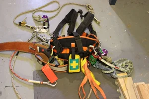

My faves:
-Left handed scabbard for my Zubat
-Small wedge for those windy days and stubborn chunks
-20$ shoulder straps from the hardware store, keeps the harness on my hips when carrying a saw and I have a small snap tied to the chest connection that I attach to my Hitch Hiker or Croll for ascending.
Pulley saver and loop runners usually come out early in the climb so I don't mind them hanging.
Is that tape I see on your flipline? - Do you find that it helps? - What do you use to tend it?
Because I'm using the Art Positioner - I find it is less forgiving on little nicks in my flipline (as it can release under tension). I might try some tape, though I'll constantly have to retape. Maybe after flipline is retired, I'll just go to rope.
Some nice stuff there.
You caught me, it's electrical tape. Fliplines are brutal for fraying with even the smallest of nicks. The tape just prevents further fraying. I was pretty pissed off when I noticed this nick because I do my absolute best to take care of my gear.
For tending I just use a short ice tail eye and eye with a micro pulley. I've tried mechanical adjusters in the past but I just prefer a hitch. It holds well, has little sit back and I find that a hitch releases smoothly under pressure. Although I've never tried the ART Positioner they seem to make quality stuff!
I love the Art Positioner (though have never tried a hitch on lanyard) compared to an ISC Rope Grab (what I used before). Though I find the Positioner's cam to be less forgiving on nicks in rope (as opposed to the rope grab) as it is slipping through a cam under tension as opposed to ''unweighting' a rope grab completely before letting it close again. It also does not run well on old, nicked, lumpy flipline (that still works ok with a rope grab)- ie, the cleaner and smoother, the better. May try a hitch in future.
