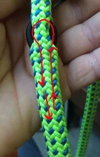

Pretty cool. What kind of bungie and how did you anchor it at each end?
Both have two legs of bungee as a core. They are 3/16" I think. One is hardware store stuff, the other is dyneema and its way better.
Both are looped through on one end like this:
At the other end on the green one both legs come out of the cover and are scaffold knotted around the cover. Then shrink wrapped.
On the black lanyard both legs are extracted from the cover on opposite sides then one leg passes through the body like the other end. Then I tied them together in a double fishermans to make the bungee a loop. The braid of the BranchSaver was loose enough that I could rotate the whole loop and suck the knot back inside and bury it. I might have been able to do the same with the 24 strand but really didn't even try.
