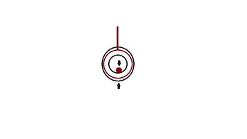

As almost all of the force on a ring is compression on one side, I don't understand how a ring deforms into an oval, unless it was rigged wrong. The rope going through the ring is applying force down onto the ring, and the sling is applying force up on the same portion of the ring on the opposite side. It is squeezing a portion of the ring edge against itself. There is some force squeezing the sides inward from the sling, but that can't be enough to deform it no matter how big a piece of wood is dropped on it. There really are no significant forces acting on a ring that is rigged properly to deform it.
I have seen 3/4 Tenex Tec snap with no damage to the ring. Yeah, it was me.
Yea, Driver billed it as necessary from the start, based of of his extreme testing that I can't seem to find the video of anymore. The myth has been dispelled at this point, as nobody it trying to block down 10k# logs on a single ring, or whatever he was using to determine his numbers.
I think the doubles look cool though, so I don't fault folks for using them. Impresses the customers.
How so? The rope as the exact same contact with the aluminum ring, be it one or two. With two it is only in contact with 1/2 of the ring on each, which equals the same had it been one ring.
The rope fibers are not short. They run the full length of the rope. They are not like the old ropes where a bunch of short fibers are wound together to make a long rope.
Sorry, but that theory doesn't hold water.
In fact, with two rings you are asking the rope to flex more than with one ring. Make the bend radius, straighten out, then make the bend radius again, then straighten out. With one ring you are just asking it to make the bend radius once and then straighten out. With two you are just flexing the rope twice as much.
Even if what you say was true, will you notice the rope lasting any longer? And if you did, would that tad bit of extra life be worth the 30-60 dollars extra you spent on that second ring?
But they look cool. I actually have one myself. Someday I will take it apart and make two useful singles out of it.
You are combining the two 90 degree bends, probably because they are so close, when it should be one on one. Think smaller by imagining how the fibers themselves react to the two bends.
