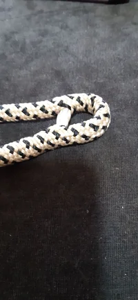

Gotta ask- this should be scary right? This has gotten pretty minimal usage, only as a lanyard / never loaded quick/dynamic or anything, the cord's looking great yet the tag is ripping? It's an Epicord from Bartlett's:
My splicing method is wire-fid, haven't found my favorite way to use it but basically I get the core taped to a tapered tail, then I work the aluminum wire through it and whether I came in the exit or entrance with the aluminum, I end up pulling-through a properly-tapered, strong-as-heck (but desk-tape lol) aluminum wires-with-core tapered bit that I've gotten through every time I've tried :D Last splices I was really just geeking-out on making sure the yarns/tracers stayed perfectly in-line as the rope turned the splice and went into itself!
Finished product for that one was quite tight, cover is bulging, not as tight as b.moon though lol but still I worry about 'cinching' and can't find info about it - what if it was 1/2" worse than this? This hasn't gotten real use so wouldn't be surprised to see it suck-up another 1/2", if it was already 1/2" deeper I expect that'd be a problem IE 1" from where it is now, wouldn't it just get so tight it'd stress-out along the thimble?

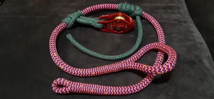

@Samsquanch I love it, I'd hated all the slings with these pinto & similar micropulleys (still not a fan LOL) but splicing those prusik legs onto the thing was a great idea (can't see in the pic but presuming there's *something* fortifying the metal//rope interfacing itself?) What's the 2nd prusik for? I'm a huge fan of prusiks wherever possible lol but it seems that side already has an eye (or is it for use opposite the larger eye? So many configurations there!)
So. That extra prusik is for retrieval, it usually has a retrieval clip on the end, i just have to go buy one. The wire in the soft eye has the ends rounded over then two layers of glue lined heat shrink over it to encapsulate it.
I like these style rope guides. The small eye splice can be for many things, like tying the retrieval side of a canopy tied srt line to it for safe retrieval of the rope guide.
Now that I think about it I really should splice a 2nd blue moon eye&eye sling with those 1/2" metal thimbles, would like to have (1) 4' length for each of my 3/4" slings they bite well (of course) and a BM prusik with thimbles is pretty strong, would be able to leave one on each of the 3/4" slings so that when there's a crotch I can just tighten it to the right length and have a 2-legged sling instead of 1 (well, 1 leg would be the BM prusik end, but 2 BM legs spliced properly is still like 2/3rd the strength of the 3/4" sling, would obviously down-rate appropriately in that configuration!)
4' was about as short as you'd wanna go if putting it on 3/4" (or even the 5/8 actually) polydyne, unsure how bad polydyne is with 'nominal' (ie 'not real') sizing but know tenex is even worse, but with a prusik it seems it's not so much "optimal is 25% shorter diameter", it's "optimal is at least 25% shorter diameter", shorter should only improve bite-quality!
What do you mean by 'style rope guides? And lol at the prusik being for retrieval, am I guessing right that someone just wanted to splice? You've gotta have spliced everything else in your kit to be splicing the retrieval lines on! I hadn't even thought of that much TBH, I've been lucky enough that I can usually free climb or spur my way to an anchor spot so honestly I suck at my slingshot and the line/ball (keep meaning to practice damnit!!) but need to work on my ground install/retrieval skills at least getting in the habit of setting retrievals, although I'll be tying-on day-glo paracord not splicing pretty accessory cord on ;D What kinda cordage was that BTW? Real attractive stuff!! Sadly Yale is very boring and I'm stuck on their products (learned most of what I know from people who primarily hover towards Yale, have looked into them enough, wish they'd innovate some more - Atlas, at 4.5% stretch, I am sure will prove to be a great innovation / step forward, wish Yale (and Samson) would get on that (nystron, samson's most-dynamic offering, is far older than yale's esterlon&polydyne lines, and they're the most-dynamic cables available except for Atlas!)

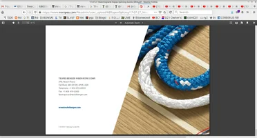

LOL I was trying to find info and stumbled on something funny- NEropes' splicing-tutorial is actually just a copypasta of Teufelberger's, and I don't just mean the templates themselves I mean they accidentally left TEUFELBERGER'S CONTACT INFO at the back page of 'their' splicing-guide:
NEropes using TFLBRGR's template for their splice tutorial LOL didn't remove TFLBRGR's info f...webp
They (NEropes) 'properly' swapped their name on the cover page but they forgot to remove the Teufelberger contact-info from the final page of the splicing guide, was reading it thinking "this is familiar" LOL then find that at the end, thanks NEropes I read that in-hopes of catching something new since that's the only way I've found to get more-advanced splicing info is to comb-over stuff and hope for a new detail here&there, sucks to flip through a whole catalog only to realize it's one you've already flipped through!

The cordage is poison ivy calimine. This style, i guess its like the pulley guide from teufelberger. The extra prusik is to allow to pull close to the pulley for better chance of retrieval. Its a prusik and moveable to allow sinching by putting the pulley prusik through the soft eye.
