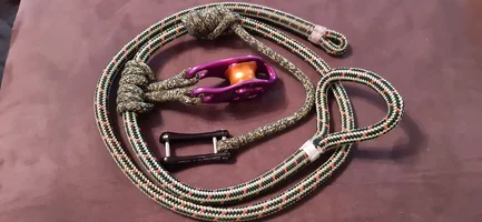

Revamped the rope guide. Much happier with it

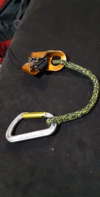

New boots have the clip n step thingie, so modified the micro saka on my harness

Nice job on the rope guide/pulley saver too!
Few questions -
What did u stuff the eye with?
What did you end up with for length on your Pinto Rig prusik. The splice also looks very flexible for having the bury so close to the wraps.
Sam that mini is freaking awesome. If i hadn't blown what i did buying the dang Haas Velox that won't even fit around my fucking boot, I'd tear it down & make what u have right there.. So much more compact & stowable. Really nice work right there.
Few questions -

I like it, it's just a croll with a length of bungie cord clipped onto the back of my harness, just pulls out and goes over the shoulder. I can roll it up quickly and stuff it into the chalk bag on the back of my harness. I had a spliced loop on it before but since i have the clippy boots now, changed it.

The eye has a 3.5" bit of 6mm stainless steel wire with the ends rounded over, soaked it in super glue and two layers of heat shrink over it. Thats sitting in the core of the top of the soft eye.
I didn't really measure it, i wrapped the cord on the rope, marked where i wanted the pinto to sit, added an inch and a half to each end since thats what i lose to the splice. It was stiff as a wedding prick initially, after hidden stitching the splices i worked them by hand for a while to stretch and soften the splices up enough to get it on the tether.
