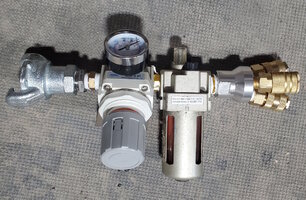

If you wanted to get a bit more punch out of your air chisel upgrade to Milton type V high flow air fittings.
Per your recommendation, I upgraded to high flow fittings on air hoses and the tools. Haven't used it yet, but I fully expect more power. Or, at least not a drop in power when running 2 chisels at the same time.
I also replaced the old regulator with a high flow regulator.
Additionally, I took out the quick connect fittings between between the Chicago/Dixon fitting and the manifold...it is all straight piped with 3/8" fittings to try to maximize air flow through that setup. Here is what that looks like now. (just realized, shoulda taken pic from other side. The "top" quick connect on the manifold is the non-high flow one I didn't switch out)
Thanks for the recommendation!
