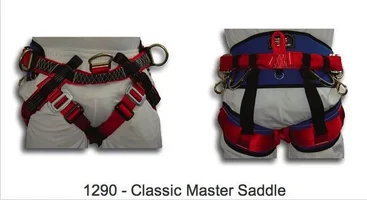

Leg straps themselves are the problem. And I don't mean the leg straps on the Sequoia. I mean LEG STRAPS.
I share the same issues as you're experiencing. On my very first saddle ever, something I got from a pawn shop before I knew crap about crap, it was a bare bones saddle, but I was a bare bones climber. The leg straps, though, were killin me. I assumed it was the saddle. I let it go based on discomfort on each of my inner thighs, and various parts in between, if ya know what I mean.
Next saddle, Buckingham Classic Master Saddle. Definite upgrade, same problems. And no floating bridge. the leg straps were seeming to get worse with upgrades in saddle, but looking back, I was becoming a better climber and finding new, funky positions. There was nadoidal pain and that fixed front-center attachment position seemed and felt limiting.
Next I went to a Buckingham Versatile; floating bridge <u>and</u> a bosun seat. At that point everything changed. This is like 8 years ago. I modded this saddle to how I wanted it and it is what I'm climbing in at the present time. For the last two years I've been looking for something better.
Last season I got to use an Ergovation for 60 days. I wanted to love this saddle. I pushed that saddle hard and y'know what it did for me? It pinched my balls REGULARLY. A frickin-noying. This happens in all leg strap saddle, even the Ergo, even the Treemotion. The world's best and most expensive and highly developed Arborist saddles and they are plagued with this leg strap getting pulled up into the groin every time you do anything lateral.
Any guesses as to how many commercially available BOSUN SEAT saddled with a floating bridge? How many does the world have to offer us?

It pinched my balls REGULARLY. A frickin-noying. This happens in all leg strap saddle, even the Ergo, even the Treemotion. The world's best and most expensive and highly developed Arborist saddles and they are plagued with this leg strap getting pulled up into the groin every time you do anything lateral...
