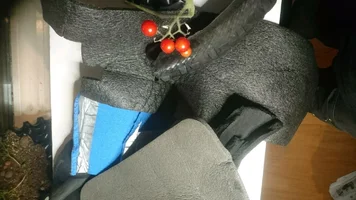

We are putting up a swing for a kindergarten. My preliminary idea is to dress the branch in a layer or two of foam sleeping pad, then something stiffer, like knobbly black building plastic. Then tie the swing anchor around that, tight so nothing moves.
The branch will be able to grow an inch or so in diameter before the foam is compressed.
Are there better ways?
