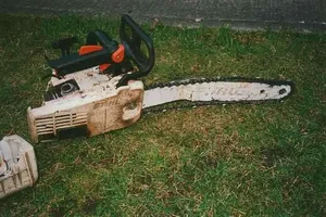

Oh, but make sure you make cuts correctly if you're cutting with a saw attached to your belt.
