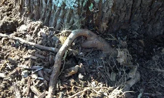

A client of mine has a red maple that is severely stressed. Ninety percent of the leaves have fallen off, some die back in the crown, and compacted soil from heavy machinery.
I have drilled holes with and auger bit a foot deep introduced compost, mycorrhizae, and peat moss to aerate the soil. Taken soil samples to test; will post results later. There were some small girdled roots at the surface that I removed also.
I also applied some Mauget Stemix 2ml injections. I don't know if this was the wisest decision but know that it can be beneficial for foliar and root growth.
I have limited resources as a small company in its infancy. I don't have an air spade so if there are any suggestions for me to further check for girdled roots, suggestions are welcome. I also have ordered a Ross root feeder to help with the soil compaction problem. I took some pictures of the leaves to appear to have bacterial leaf scorch? There is no signs of insect infestation.
Please help! Thanks in advance.

The one photo indicates to me that the tree might be dead.
"Are there new buds? Are the twigs green and pliable or do the break easily?" is the first place to start. Then scrape bark and look for live tissue then do a stored starch test.

x2 Jeff. Is the raised bed around the tree not a red flag? It's the fisrst thing I noticed when I opened the attachment and would probably be the starting/stoping point of any evaluation of that tree.

The raised bed around it was my first concern. It had mulch right up against the tree. The soil though is even with the ground the whole way around the tree. Only the top course is mortared in.
The Tree is still alive it has new bud growth all over it and pliable branches all over which are still green and alive.
The soil all the way from the outside of the raised bed past the dripline is compacted and barely absorbs water at all.

Pretty sure, most likely a crimson king or royal red. Your first pic, the odd looking flat spot at the ground on the right side of the stem could just be the way the pic was taken but looks like it would suggest very large problems below grade. We see flat spots and malformed root flares on trees of that vintage and species up here and they usually are too far gone to do anything about.
I do not think it is BLS. Appears to be a water (lack of) issue perhaps created by compacted soils and a poor root system.
