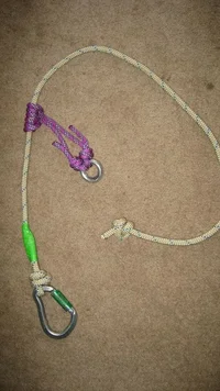

I was pulling my rope the other day and the false crotch looked strange to me. When I got it down, this is what I found:
I never imagined the beer knot would work loose like that. I realize now I've been climbing on that same loop of webbing a long time (yrs?) without really inspecting the knot. Just a reminder to do
thorough gear checks regularly on every piece of gear.

I've been using this type of webbing with beer knot for years and have never seen that happen before. Thanx for the post reminds me to check my gear. I don't use those loops for personal safety, mostly speed lining and other rigging.
That's pretty enlightening. I've used water knot runners going on 30 years now, mostly climbing on rock and never had one come untied.
I just started using beer knots about a year ago, I'm going to check every one every time I use the now. It makes sense to stitch them down to keep them from working loose. I guess not being able to easily see that one end isn't such a good thing.

I'm glad those girth hitches held, sometimes they slip. You must be living right.

I had this problem too when attempting to pull a FC with a pulley, so I went back to the ring. Here's my newest FC.
I leave at least 3" on either end when tying a beer knot, never had one come undone.

thats scary man, is the webbing rated for fall arrest? i use these slings often, sometimes for personal support, i just dont know if its rated or not
REI lists mil-spec webbing as rated to 18.1 kN. since it is doubled in a loop, that's more than enough to make me feel safe. I'm not 100% positive ANSI still sees it that way.

That webbing is Made for personal support. Some of the stitched slings I have are rated at 22kn. If used for rigging they should be replaced often since they are nylon.
Tied webbing slings have always been accepted as long as the webbing has a breaking strength of at least 2,700#.
When I've tied slings using a water knot I always pulled the end of the sling up a little and tacked it with my sewing machine. If the tail didn't have the small 'loop' I knew that the water knot had set a bit tighter. This was a way to monitor movement.
After I learned the Beer Knot I didn't tack the ends down. All slings get attention like any other gear for wear.

I 'lock stitched' the tucked end just for that reason.
ditto. had a beer knot on the loop on one of my truck chocks work its way loose - spooked me into stitching them from then on. glad you were unhurt! i guess you'll be a girth hitch believer from now on.
