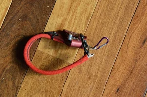

My new SAKA from Richard Mumford arrived last week, and I've gotta say this is one nicely made, well thought out piece of gear. The strap has some stiffness to it, so that with every stride it just glides nicely up the line. I made one of these last year along Richard's design, but this one functions better. The fact that the ascender easily glides all the way up means it quickly gets out of the way of the Pantin on my right foot, so I'm having much less of a problem with kickout. The fact that the bungee is doubled gives it plenty of pulling power. The length is adjustable, and it's easy to replace. The removeable footloop has an elastic strap and it stays nicely on my boot. My tendency would have been to go for all black, but I decided to go for red inside and black outside so that it would be recognizable as a Mumford original!

I love that design, I made one months ago also. The only problem I had once and it was not Richards design problem it was me not thinking. I left it in the hot car all bunched up, and you can guess what happened. Now I make sure it is flat when I store it and I hsve never had any issues. Just a heads up, Rich did not make mine but most tubing will tske a shape if let heated up.
Yes, 110 + shipping.
P M me
I think it is a bargain at $110. 00. I sewed one up by hand and by the time I had all the components and did all the labor I don't think I saved a penny, plus your versions are a lot prettier than mine. The only gripe I have is that it does not fold up into a little ball in my canopy bag like the single bungie system that I normally use..
I understand.
The SAKA can be rolled into a circle but I have found that the resulting loop can snag and I don't like the curve that develops. It can also be put in a small throw line storage bag.

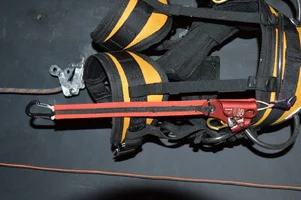

Personally I have found that hanging it from my saddle with the ascender side up to be the least intrusive.
