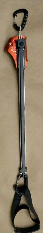

SAKA X?

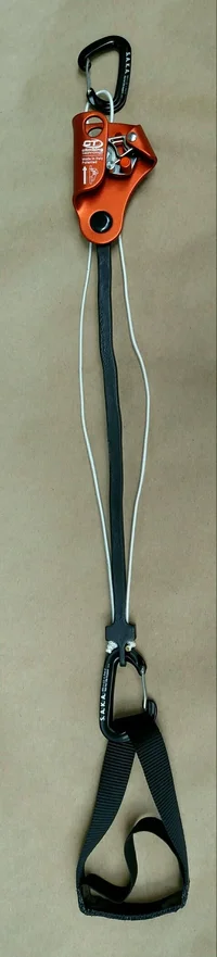

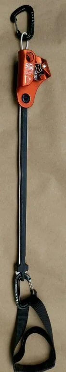

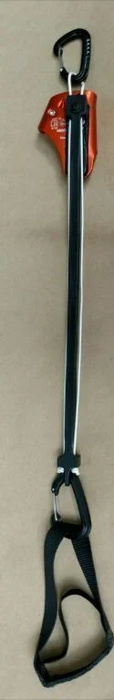

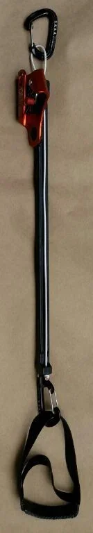

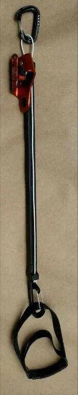

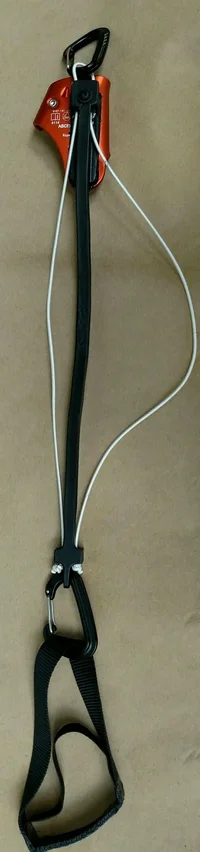

Looks like more opportunity for the exposed bungees to get snagged or chafed/ abraded.
The webbing embedded bungee idea sounds like something akin to a heavy duty truck mudflap. Which would be better than the el cheapo rubber bungees with steel hooks that break or crack after short, but happy lives. Not real fond of them things.
Have you stuck it in a freezer overnight (to simulate 6 months of life in Ontario) and then tried climbing on it?
I dunno, Richard....seems like you are going the wrong direction here, imo. The SAKA is a Bulova; the SAKA X is a cheap Timex....I want to see a SAKA Breitling.
I don't think the webbing embedded rubber part assists the bungees, it only takes the place of the tubes and the tubular webbing of the previous model. It looks like it would be easier to store on your harness when not in use.
Is it small enough to place inside anything? PVC? Tubular webbing? If it's a patient inspired change you can design it where the user could add on some common thing for themselves. It looks like it would be easy enough to add your own tubing. If there were a little recess for the tubing to fit into that would be dope.. A quick trip to any hardware store for some tubing and a few zip ties.... Just sayin
