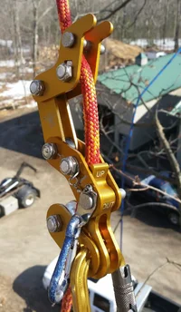

image.webp image.webp So Whip had my runner, making a minor repair on it. And made my tending tether even better. The one thing one needs to be aware of is in the second pic. If tether be too long, it could hook the bird. Also the attachment to chest harness could hook the bird. All in all I like the tending point, as it is evenly pulled. I never liked the lopsided pull.
You can see it in the first pic kinda. Somehow I lost the nub on the side of the body that keeps it from collapsing too far on ascent. And my ascent was really effed up for a while. Not really sure how it happened. Or when even. I lent it out for a while, and hadn't really been using it this winter, so I didn't take notice of it till this so called "spring" that's been going on in between periods of snow. It wasn't unsafe, just inefficient. Anyway Eric welded a nub back on for me.
