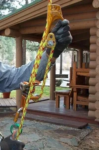

90% of the time, I will use the Pantin. I find it very fast and efficient. Many people have trouble keeping the Pantin engaged until things fall into place technique and adjustment-wise. If it is a very short rise, I will footlock the tail. If it is a very awkward position, I will use the 3:1 with my modified Petzl hand ascender that I can click on and use with one hand and remove and place back on my saddle with one hand.
There are always ways to overcome obstacles in movement.
Dave
Swinging your heel backward is the movement for kicking the Pantin off. Lifting your knee upward helps to advance the rope through the Pantin, somewhat like stepping up onto a tall stair. Somewhat of an unusual motion until muscle memory kicks in.
