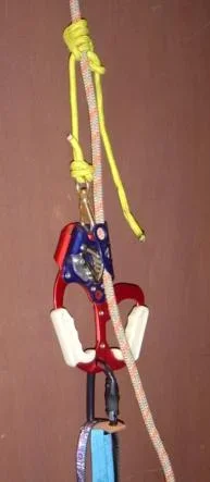

I scrounged an old packsack buckle to form a closed loop at the boot...see attachment.

Ken;
Here's another shot in the attachment.
The Kong has a back up safety, the light blue runner goes to my saddle, the other runner goes to my left boot.
Add a Distel to the rope plus the pantin and there's no way you are leaving the climbing rope by accident.
Kevin,
Tell me about the snap that you're using to attach the hitch above the ascenders. It looks like a plain hardware store dog leash snap. If so, I hope that you realize that it shouldn't be counted on for personal support.
Also, the Pantin isn't meant to be counted as personal support either. Two reasons. The P wasn't designed as personal support because it doesn;t have a locking latch. More importantly, if you fall, you'll be left hanging upside down. Any persoanl support system should be attached to the front, center, support on your saddle.
My preferance for backups is to make them as parallel as possbile. It looks like your systme isbuilt in series or cascading. Attaching the upper hitch directly to your saddle would give you parallel redundancy. That way eithe the hitch or ascender could fail and you would still be attached in a more or less vertical position.
Heck, for all I know though, I might be reading your setup all wrong :)

Tom,
Go up a couple posts. Kevin said he was using his Distel attached directly to his saddle, below the Kong ascender. This is almost identical to the system I use except I do not use the extra hitch dogleashed above the ascender or the footstrap for the left foot. He is securely attached twice without the dogleash hitch or Pantin.

The dog snap is only there because I couldn't find anything better and I thought it would be better than nothing at all.
My idea is to have something that both works well and is efficient and safe.
I can drop the entire system quickly and bomb to the ground with the distel if need be.
I have the option of resting on the distel or the Kong, much better than what I was using and it allows me to utilize equipment I already have which is another plus.
After seeing Knut climbing with relative ease and good speed with his system it peaked my interest.
I realize the pantin isn't for life support but in combination with the rest of the system it still adds an element of security.
You can add a carabiner to the pantin to lock it but I prefer my strap modification.
