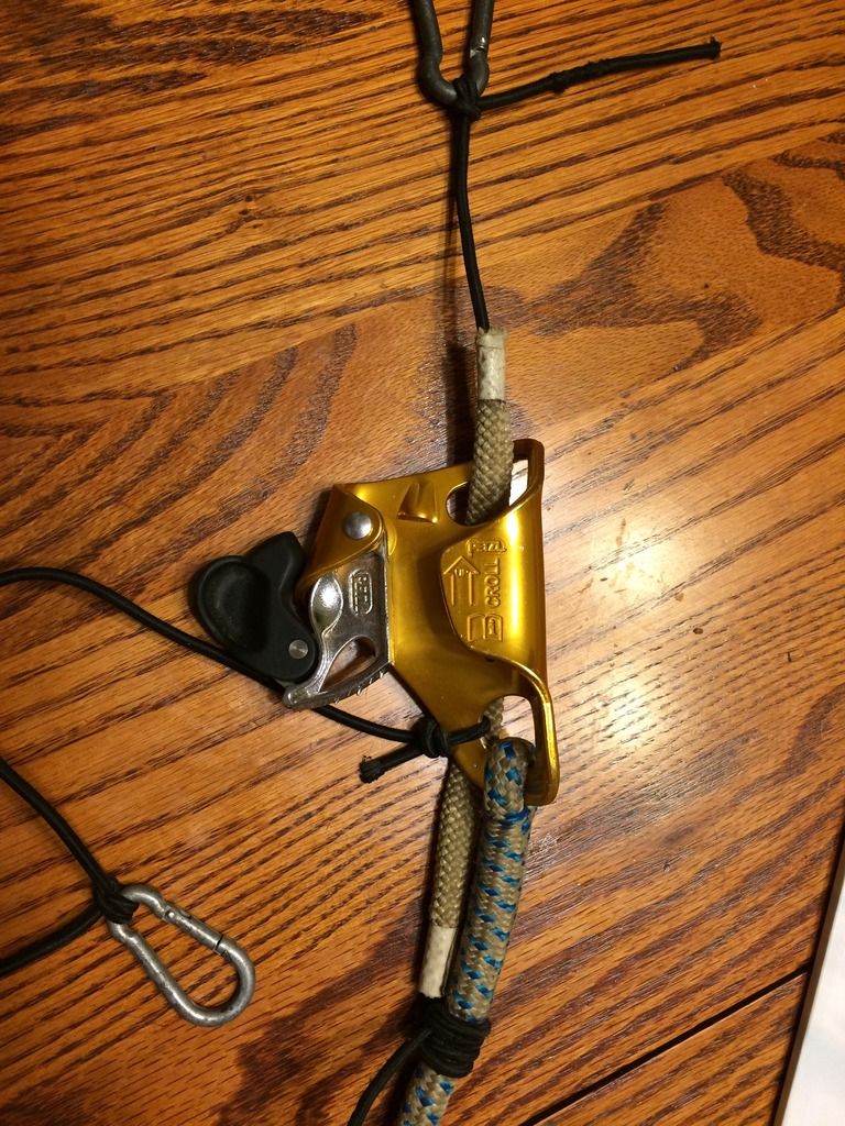

Took my bungee off the croll and attached it directly to my bridge swivel with a biner. I use a small cord to hand tend the RR. don't think I will go back to the bungee anytime soon. I Use the same settup on the RW.IMGP0001.webp IMGP0003.webp
