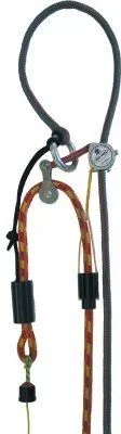

This thing Rupe?
Jim, it's the new version of the Rope-Guide.
From what I understand it's got little plastic thingies
to help retrieve it with throwline and also the retrieval
ball is substituted with some kind of plastic.
To me it seems there are too many parts on this otherwise
excellent tool.
