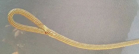

I'll take this one! Yes, in tree climbing, many of us are using spliced eyes in our climbing and rigging lines. Many of us do them ourselves. Some of the people around here have others splice for them. A lot of people ship me ropes and I'll splice and ship back, or they just buy stuff I have made specifically for them.
The big difference between us and rock climbers is that our ropes were DESIGNED to be spliced. Rock climbing/caving ropes just weren't designed for it. Though that doesn't mean they CAN'T be spliced. But at this time, there aren't industry standards for it. Basically because the rock community hasn't asked for it. But don't worry, every time I go climbing, people see me spliced lines and they get VERY interested! I'm doing what I can! /forum/images/graemlins/grin.gif
Check out this pic of a 10.2mm Mammut dynamic climbing line I spliced. I've not been able to get an official test on it, but I did do a make-shift break test comparing it to a fig. 8 on a bight and the splice won!
But for now, stick with a knotted line. You're taking quite a risk if you rock climb on a spliced line.
