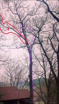

If the trees near by are not tall enough to rig directly from, set up a line in the nearest tree with the desired drop zone. Then also rigging in the tree your removing. You'll attach both rigging lines to the limbs your removing, and tighten both. The rigging in the tree your removing will catch the load, then it can be transferred into the second trees lowering line into the more suitable drop zone.
This will seem time consuming at first, but as your groundies become accustom to it, it will move much faster. Pieces can even be let "run" right into the transfer line (line set in other tree). I've done this on many trees over a house or other target.

Familytreeman hit the nail on the head: Hundreds of pounds of leaves have now fallen off, and if you'd seen it in the summer, it would've been rockin' and rollin' all over the place. With unskilled ground crew (and I've done a lot of these for friends) easiest way is to speedline as much as possible, especially all of that top hanging over the cabin. After that, chunk the rest down until it's to a height you can pull over.

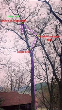

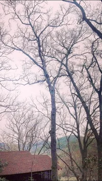

Big, tall, Red Oak a friend of mine wants me to remove. Probly 20 ish more feet of trunk not pictured below. It's got a decent bit of weight over his cabin and he wants it gone. No crane access. Nothing really reasonably close to rig out of either. It's a lot taller and skinnier especially up to than what the photo Probly gives justice. Any suggestions from the well seasoned guys on this one?

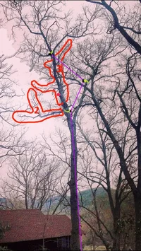

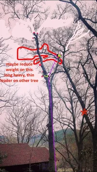

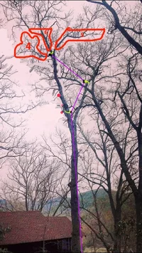

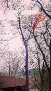

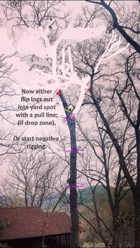

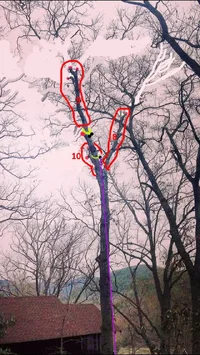

It's funny that X-man replied the way he did because I imagined him taking the time to do it just the way he did. Nice work, David. You're good like that! Something like that could be really helpful, but we don't know a few key things...importantly:
- What do you have for equipment?
- What is underneath the tree?
- Can you bomb sections right out with good hinge cut technique?
- What's the pruning history of the tree?
Using a GRCS with a skilled operator is a completely different game than a port-a-wrap. Do you have blocks?
With a GRCS, you could lift out the entire leader on the right side all in one shot. Not as effective with a porty and mechanical advantage with fiddle blocks. Also, while Oak is very strong and awesome for hinging wood, defects can make any tree fail. It looks like some previous crown raising cuts were made at some point.
- Were large limbs removed long ago leaving any cavities?
- Was there construction that altered the roots or root plate?
- Are there signs of decay inside the main stem...long fissures, cracks, etc?
I also like how Boomslang and Guy responded. Preservation is a good thing in some cases, because high levels of exposure can result from the removal. That's something I've often thrown out as food for thought to a lot of clients.
Perhaps the BEST thing an "arborist" could do is a full evaluation of the site, that tree, and the others nearby. If the one in question is within striking distance, there are apparently some others as well. Pruning weight out and reducing wind-age might be better for the investment, and a much lower cost proposition overall.
I wish I could do what David did and draw in all the pruning cuts I would make. :)
